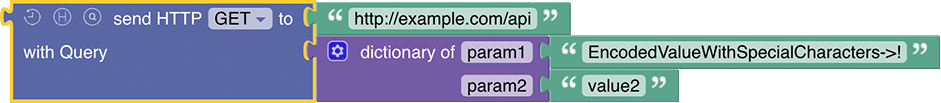

By activating the toggles the timeout, request headers and query parameters can be provided. Instead of creating a URI containing the query parameters, you can use the query parameter option and provide a Dictionary of query parameters. The provided parameters will automatically be URI encoded.
Here is an example also using a query parameter.
http-get-complex
