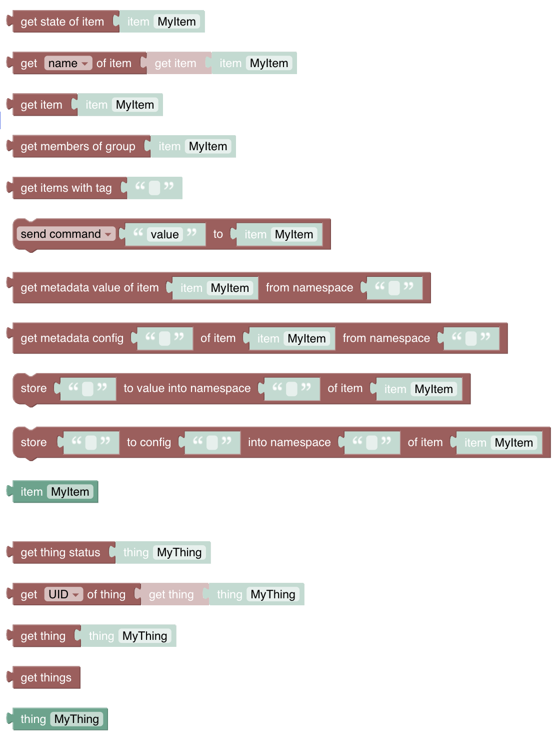

Most of the time you will want to get and set the state of an item - set a switch to ON, or get a temperature. Sometimes you may want to access the thing directly. Both are possible using the item-block and thing-block
blockly-item-thing

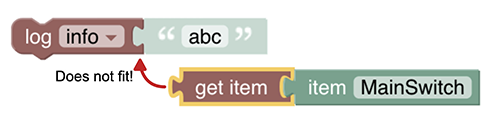

  • In openHAB3 this block does not return a String, so it cannot be directly attached to a log-block, as demonstrated below.

logging-getItem
blockly-getItemStateDoesntFit

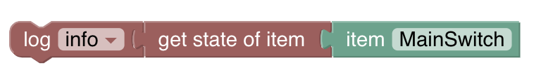

# Get State of Item
blockly-getStateOfItem
Function: Get the current state of an Item or Group
Note that most of the states can and will be directly converted automatically to a String but be careful that some of the more complex states may instead return a complex object instead.
TIP
it is recommended in this case to assign this to a variable and use the "String-Append-Text" with an empty "" to convert it into a String for further processing.
See the Item-State documentation (opens new window) for more information
Note: currently a String is not always returned. See this thread (opens new window) for reference and potential workaround.

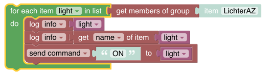

  • returns a collection of items which should be used with a for-each-block to loop over the items
  • it can be attached to a log-block which would list all items in that block in the form a string representation as follows
Hint: Make sure you are using typed variables!
GF_IndirectLights (Type=GroupItem, BaseType=SwitchItem, Members=9, State=OFF, Label=Indirekten Lichter, Category=light, Tags=[Lightbulb], Groups=[Lights]),LichterOG (Type=GroupItem, BaseType=SwitchItem, Members=4, State=ON, Label=Lichter OG, Category=light, Groups=[Lights]),LichterEG (Type=GroupItem, BaseType=SwitchItem, Members=5, State=ON, Label=Lichter EG, Category=light, Groups=[Lights])
  • Alternatively you can use the item block var the loop variable to send a command to the items of the group
The following example depicts the above possibilities:
blockly-getMembersExample

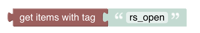

# Get Items with Tag
blockly-getMembers
Function: Gets all items with the given tags which you can iterate over via a loop
  • returns a collection of items which have the given tags
  • multiple tags can be provided which then need to be separated with a comma
  • if multiple tags are given, the item must have all of the tags ("and"-condition)
TIP
If you need an item that has one of multiple tags, then you need to use one block of each and then use the "concatenate list block" (opens new window) to combine the results.

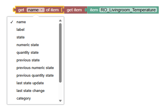

# Get particular attributes of an Item
blockly-getItemAttributes

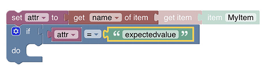

Function: Get either the current name, label, state, category, tags, groups, or type of an item as a String
It requires an item object to be connected.
These attributes are returned with the following types:
  • name: String
  • label: String
  • state: State
  • numeric state: Number
  • quantity state: Quantity
  • previous state: State
  • previous numeric state: Number
  • previous quantity state: Quantity
  • last state update: ZonedDateTime
  • last state change: ZonedDateTime
  • category: String
  • tags: Array, e.g.
[plannedTimes]
  • groups: Array, e.g.
[plannedTimes, timers]
  • type: String
blockly-getItemAttributes-fix

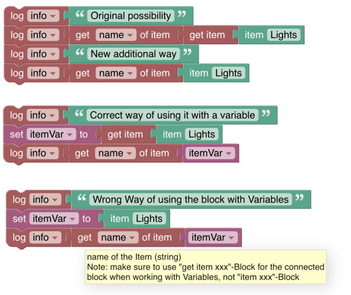

Simplified usage
Since openHAB 4.1 an optimization was introduced that simplifies the usage:
It allows to attach the item block directly instead of having to use the intermediate getItem-Block. Internally Blockly detects the added type and applies the right code generation.
Use typed variables:
Due to the fact that Blockly provides untyped variables it is then not able to detect the type of the value that has been assigned to a variable which may result into unexpected behaviour. Therefore, always use a typed variable instead

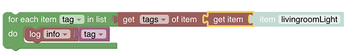

Special handling for Arrays
The attributes groups and tags return an Array of entries. Therefore
  • they cannot be connected to a block that expects a String (e.g. log-block)
  • they must be handled using a for-loop as follows
blockly-specialArrayHandling

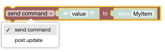

# Send Command
blockly-sendCommand
Function: Sends a command or posts an update to an Item or Group.
  • value: any state value that is allowed for that item, eg. ON or OFF for a switch.
  • Clicking 'MyItem' displays a list of Items to pick one item from
For the difference between send command and post update see "Manipulating States" (opens new window) and "Event Bus Actions" (opens new window).

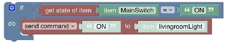

Item-block examples

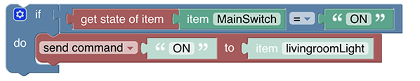

Example 1:
  • Check if MainSwitch is ON.
  • If ON, send ON command to livingroomLight item.
blockly-sendCommandExample1

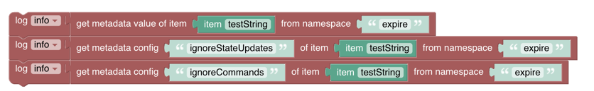

# Item Metadata
The metadata blocks provide an easy way of accessing namespace metadata information both for reading and writing. Accessing config metadata on hierarchical levels as well as variable support that allows iteration over computed names is supported (see the examples below).
Note: Metadata blocks are not available for Nashorn but only for GraalJS / JS Scripting.

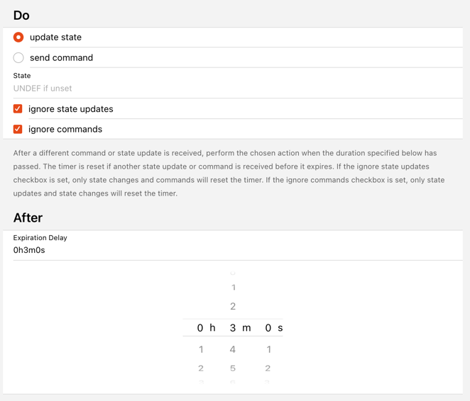

Here is an expire metadata definition which is visualized as
metadata-expire
and modelled in YAML as
value: 0h3m0s
  ignoreStateUpdates: "true"
  ignoreCommands: "true"
with the blocks that can access it:
![blockly-metadata](../images/blockly/blockly-metadata.png)
There a two different type of blocks:
The value block is the main one for the _value_ of the namespace, which is also directly shown in the MainUI's list of an item's metadata, while the _config_ part holds more complex configuration of that metadata structure below the entry _config_.
The following blocks allow to _change_ the config values in the namespace _expire_:
![blockly-metadata-change](../images/blockly/blockly-metadata-change.png)

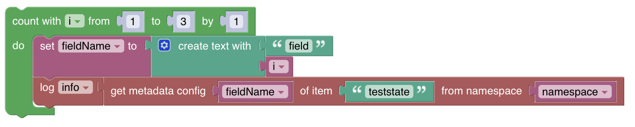

which allows deep hierarchy property access via a configkey-dot-notation like one.two.three
Using variables and loops properties like field1, field2, field3 can even be accessed in a computed way:

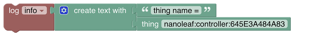

Example
blockly-thingExample
will write the following ID of the thing into the log
thing name = nanoleaf:controller:645E3A484A83

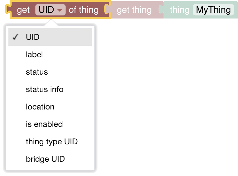

# Get particular attributes of a Thing
blockly-getThingAttributes
Function: Get particular attributes of a Thing
It requires a thing object to be connected.
  • UID (unique Thing ID): String
  • label: String
  • status (like ONLINE/OFFLINE): String
  • status info (status plus further info like "light not reachable"): String
  • location: String
  • thing type UID (unique ID of the Thing type): String
  • bridge UID (unique ID of the Bridge): String
