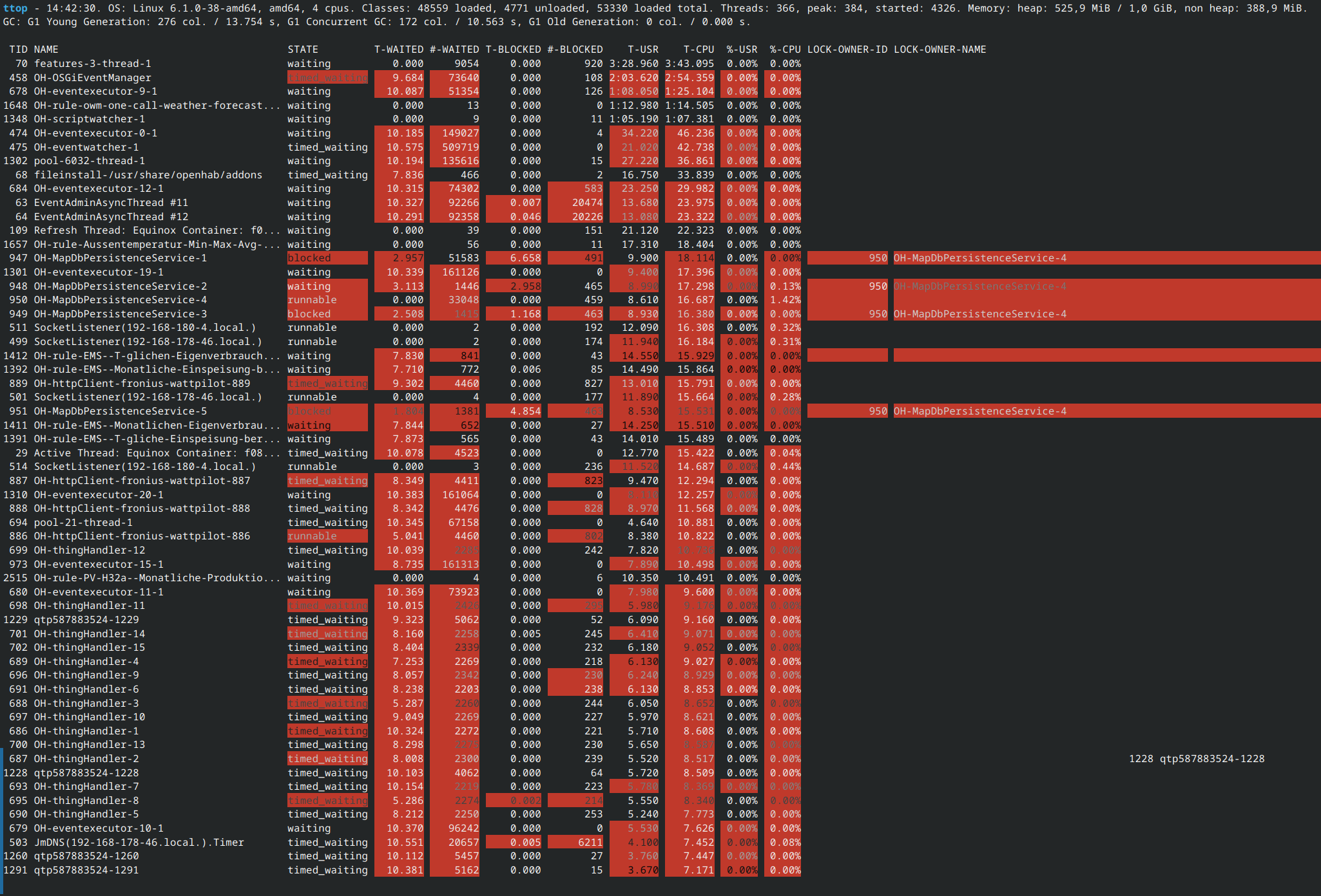

# Thread Monitor
When experiencing high CPU usage by openHAB, one of its threads might be running wild.
Similarly to the familiar htop
command on Linux, Karaf provides the ttop
command to analyse CPU usage per thread.
The following example of the ttop
command displays thread ID, name, state and various stats about each thread, all ordered by the CPU time:
ttop --stats=tid,name,state,waited_time,waited_count,blocked_time,blocked_count,user_time,cpu_time,user_time_perc,cpu_time_perc,lock_owner_id,lock_owner_name --order=cpu_time --millis=300
To get more information about a thread, you may use the following command, where XXXX
is the thread ID:
threads XXXX
# Example
As you can see, there are a few rule and MapDB threads consuming a good amount, as well as openHAB's OSGiEventManager
To get more details about the OH-OSGiEventManager
thread, use the threads
command: threads 458
The following information is printed to the console:
