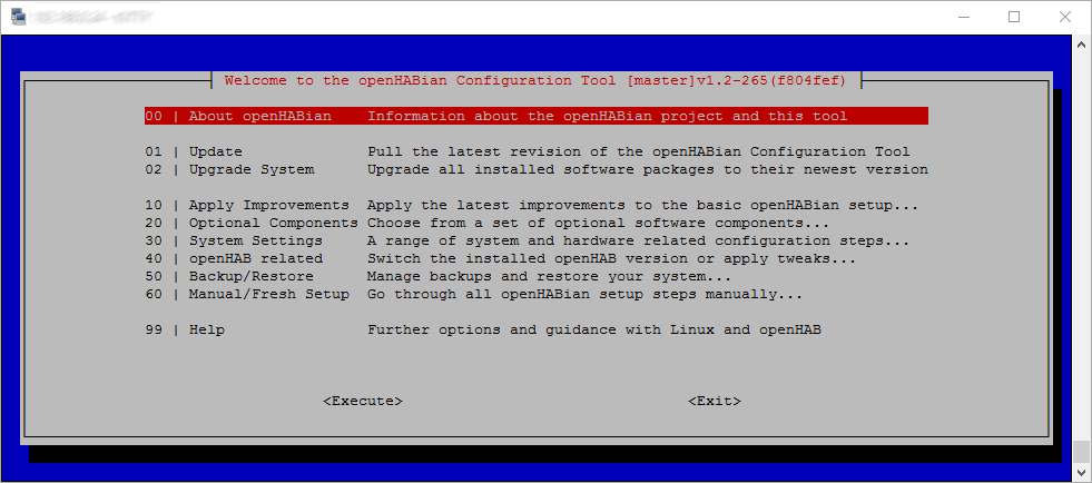

# openHABian Configuration Tool
The following instructions are written for a Raspberry Pi but should be applicable to all openHABian environments. Once connected to the command line console of your system, please execute the openHABian configuration tool by typing the following command:
Hint
sudo executes a command with elevated rights and will hence ask for your password.
The default password is openhabian.
sudo openhabian-config
The configuration tool is the heart and center of openHABian.
A quick note on menu navigation:
Use the cursor keys to navigate, Enter to execute, Space to select and Tab to jump to the actions on the bottom of the screen. Press Esc twice to exit the configuration tool.
