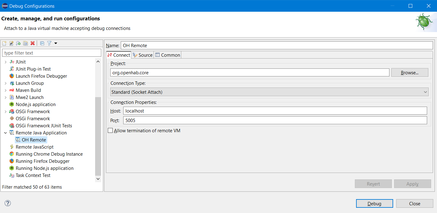

Eclipse ​
Create a new "Debug Configuration" for remote debugging:
installer
Once that is done, click Debug and it should connect to the running openHAB instance. Nothing will happen initially, you must set breakpoints and wait for the code to reach one of them.
