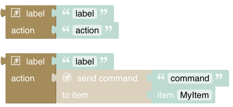

# Label / Action combination blocks
These blocks allow to create a notification with labeled button and an action that is executed when the button is clicked.

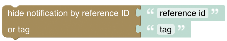

# Hide Notification
The last block allows hiding a notification based on a reference or a tag that was provided to the original notification.

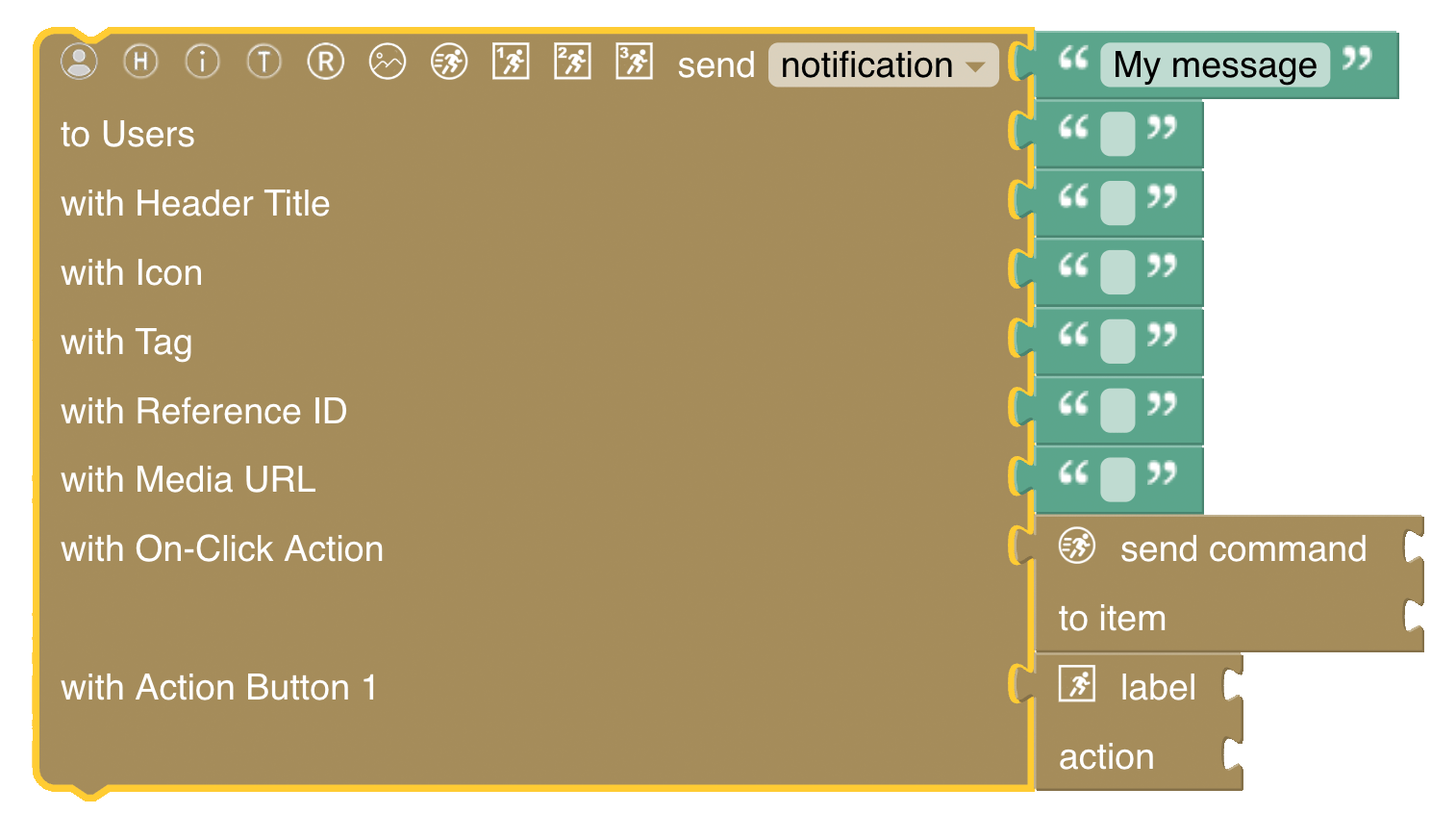

As the notification block allows a lot of flexibility, it provides many options to be switched on or off. Let's, therefore, start with the simplest form of the block by just dragging it into the workspace. This will create the following block and will send a notification "My message" to all devices and users:

The block has several icons that allow additional options to be revealed.
- person: send Notification to specific cloud email user
- H: allows specifying a Header Title
- i: allows specifying an icon that should be shown with the notification. Use the icon names of the openHAB iconset (opens new window).
- T and R: allow providing a tag and a reference to the notification
- Picture: allows attaching a link to a publicly accessible image URL
- Running person: allows attaching an action to the notification when clicking the notification
- Running person 1 / 2 / 3: allows attaching up to three buttons to the notification which can result in a particular action when clicked
After having clicked on all of these icons, the block will look like this:

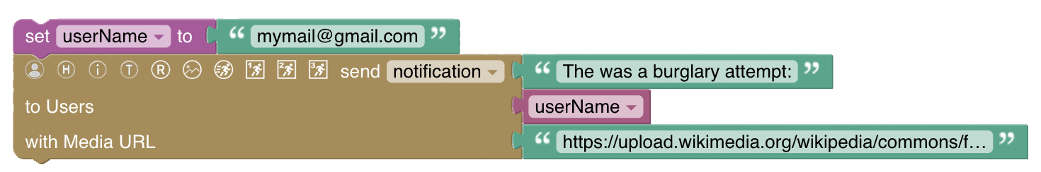

By activating the media URL option, the block will allow attaching a publicly accessible image URL to the notification.
The following example also shows that variables can be used to provide blockly information to the notification.
In this case, the user to send the notification to is provided by a variable called userName.
results into
The public media image URL used here has been taken from Wikimedia (opens new window).

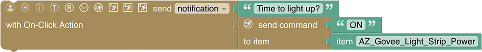

When choosing the Person icon, the block will allow attaching an action to the notification. In general, an openHAB action as specified in openHAB Cloud Connector: Cloud Notification Actions can be attached to the notification. If you want to create such an action yourself, you can use just use a Blockly text block to provide the action.
However, this usually isn't recommended as Blockly already provides blocks that allow to create these actions conveniently.

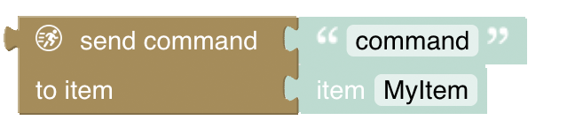

Therefore, when clicking on the action-option by default, it will bring up the following send-command block that still needs to be configured (and might result in an error on saving if not configured).
For convenience, it automatically connects a "send command" block to the notification block which requires to be configured (it can be replaced by open / call Page Block instead later on):
- The command to be sent, e.g. "ON" or "OFF"
- the Item to send the command to, e.g. "My Light Switch"
This will result in a notification, but with a special functionality: When the notification is sent, it will show a button with the text "ON" and when clicked, it will send the command "ON" to the given Item, in this case the configured light.

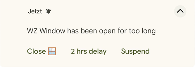

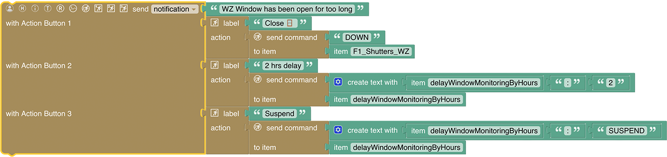

This is similar to the On-Click Action, but allows to attach up to three buttons to the notification that can be chosen from. An example would be to send a notification that a windows has been open for some time and then provide the user with the following three options:
- Close the roller shutter
- Remind me in two hours.
- Suspend the notification until the window is closed
Please note that on iOS, a tap & hold on the notification is needed to make the buttons visible.
results into a notification that looks like this:
A few notes on the button configuration above:
- The first button sends a DOWN command to the specified roller shutter Item.
- The other two buttons are configured to send a command to a specific virtual String Item which includes a combination of the Item name and what should be done. There is a rule that listens to that virtual Item, extracts the Item and specific command that has been separated by the colon (e.g., myitem:2 which is interpreted to delay monitoring for that Item by two hours) and processed it accordingly.

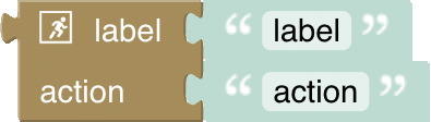

Attach a generic action command
In case you want to provide your own String-based generic command, you can use the following block instead. It provides a combination of Label and String action command:

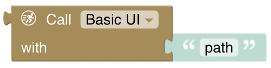

# Actions: Open / Call Page
Instead of sending a command, the notification can also open a specific page in the openHAB mobile app.

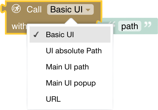

The options are:
- Basic UI: opens the specified Basic UI page
- UI Absolute path: opens the specified UI absolute path
- Main UI: opens the specified Main UI page
- Main UI popup: Allows opening a popup in the Main UI
- URL: opens an arbitrary specified URL
For more information, see openHAB Cloud Connector: Cloud Notification Actions.

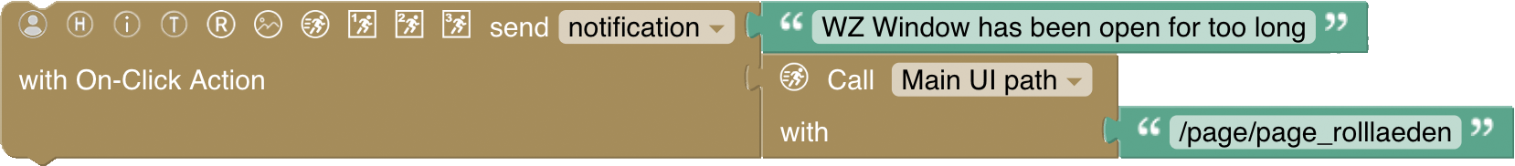

Here is an example of a notification that opens the Main UI page "page_rolllaeden" (the rollershutter page) when clicked, so the user can choose which rollershutter(s) to close:
This allows comprehensive action options for the user in case a notification requires multiple user interaction options that cannot be easily provided by the notification buttons.

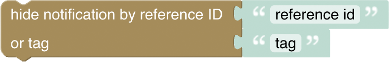

# Hide Notification
The last block allows hiding a notification that has been sent before. A notification can be either hidden by providing a tag or a reference. A tag can be used to hide all notifications that have been sent with the same tag. A reference can be used to hide a specific notification that has been sent with the same unique reference.
Usually, hiding a notification is done when the condition that has triggered the notification is no longer valid, e.g. a window that has been open for some time is now closed again.
Tip: A good convention is to use the Item name as reference in the original notification, so you can hide the notification when the Item changes state, e.g. a window sensor that has been open for some time and then closed again.
