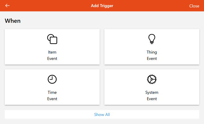

Triggers ​
Under triggers, click on the green + icon labeled "Add Trigger" to define what events should cause this rule to run. This brings up a form that lets you choose the type of the trigger and enter some information about the trigger.
rule triggers dialog
We need an Item changed event to trigger this rule so it runs when the cloudiness percentage Item changes. So I select "Item Event" and select my Item and click "Pick" in the upper right corner.
pick item dialog
Choose "changed" since we only care when the Item changes. Notice the title and description is filled out with reasonable information.
rule trigger dialog

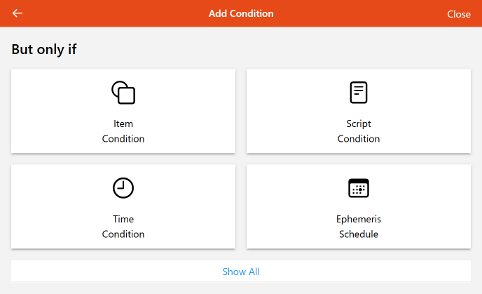

Conditions ​
In this case we have two conditions. We only want the actions to run when the Item is at or above 50% and the status Item vIsCloudy isn't already ON.
Click the green + icon under "But only if" labeled "Add Condition".
rule condition dialog
Choose Item Condition because we want to check the state of an Item and select the Item. Note, sometimes if the Item is not part of the model it can be hard to find. If that happens to you, select any Item to start and then you can get a flat list of all your Items on the next screen.
In this case we want to check if the vCloudiness Item is >= to 50 %.
rule condition vCloudiness > 50%
Notice the %. This Item is a Number:Dimensionless representing a percentage. So I've used the units here. This will work with any supported units of measurement and there will be a warning in the logs if your Item has units but the "State" does not.

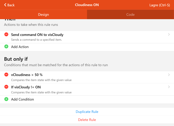

Next we don't want to run the actions if vIsCloudy is already ON.
rule condition vCloudiness != ON
Actions ​
Finally, we want this rule to send the ON command when triggered and the conditions are met.
Click the green + icon labeled "Add Action" under the "Then" section and choose "Item Action". By now the steps should be familiar, select the Item, in this case vIsCloudy and you are presented with the Item action form. In this case we want to send command ON.
rule action send command ON
The rule is now done! Click Save and watch the log for errors and to see if the rule is working (more on that later).

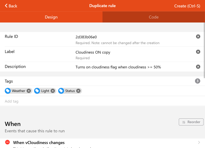

Copy a Rule ​
We now have a rule that sets vIsCloudy to ON and we need a corresponding rule to trigger it when OFF. Since this second rule is very similar to the one we just created, we can copy and edit the rule.
This can be done one of two ways.
Using the Duplicate button ​
Scroll to the bottom of the design tab for the rule we just created, and click Duplicate Rule button.
basic rule duplicate
Edit "Rule ID", "Label" and "Description" as appropriate.
basic rule duplicate 2
Scroll down to "Then" and click the "Send command ON to visCloudy" Action to edit it. Change the label and the command so that they reflect OFF instead of ON.
Using the same logic, click and edit the two conditions under "But only if" to require <= 50% and = ON instead.
Click Create in the upper right corner to save the new rule.
