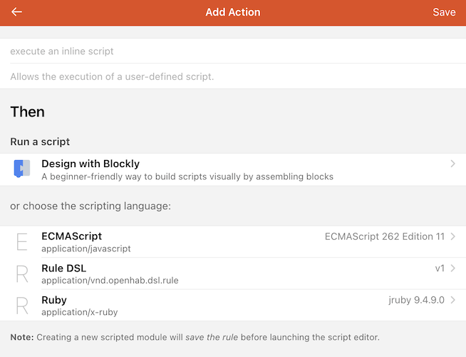

Just like in Blockly, we will create a new Action but instead of choosing Blockly, we will choose ECMAScript or Ruby.
select language
This will open a blank text field where you can start typing your code. This text field provides text highlighting and some code completion which helps with coding.
