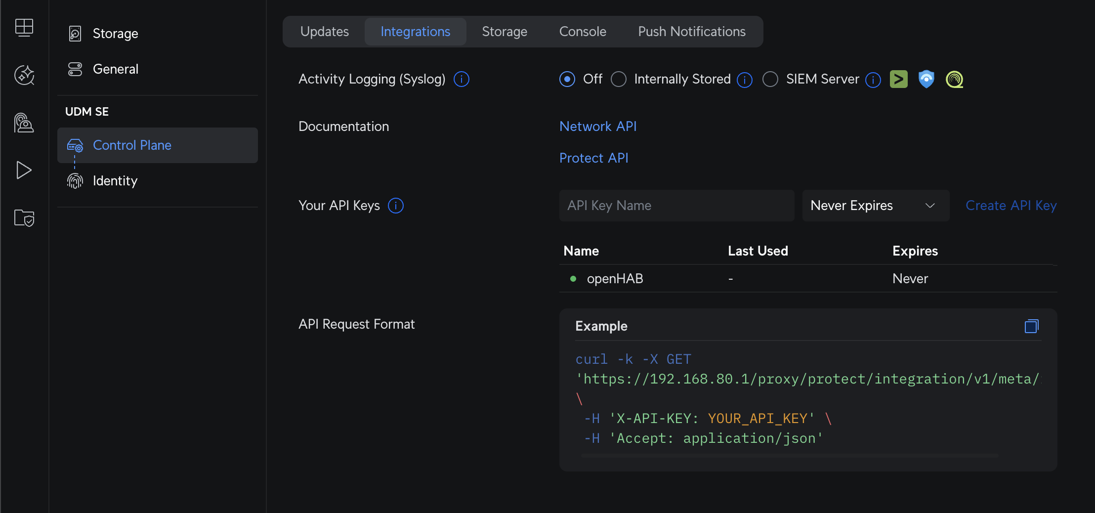

Authentication:
The binding requires a local UniFi Protect username and password to access both the Private and Public APIs.
- API Key (Token): If not provided, the binding will automatically create an API key named
openHAB-<thing-id>for the Public API. The key is stored in your thing configuration and reused on restarts. - Private API: Uses cookie-based authentication with the provided username/password. Session cookies are persisted and automatically refreshed when needed.
Manual API Key Creation (optional):
If you prefer to manually create an API key:
- In the UniFi Protect UI, go to Settings → Control Plane → Integrations and create an API token.
- Copy the token and paste it into the
tokenfield in the NVR bridge configuration.

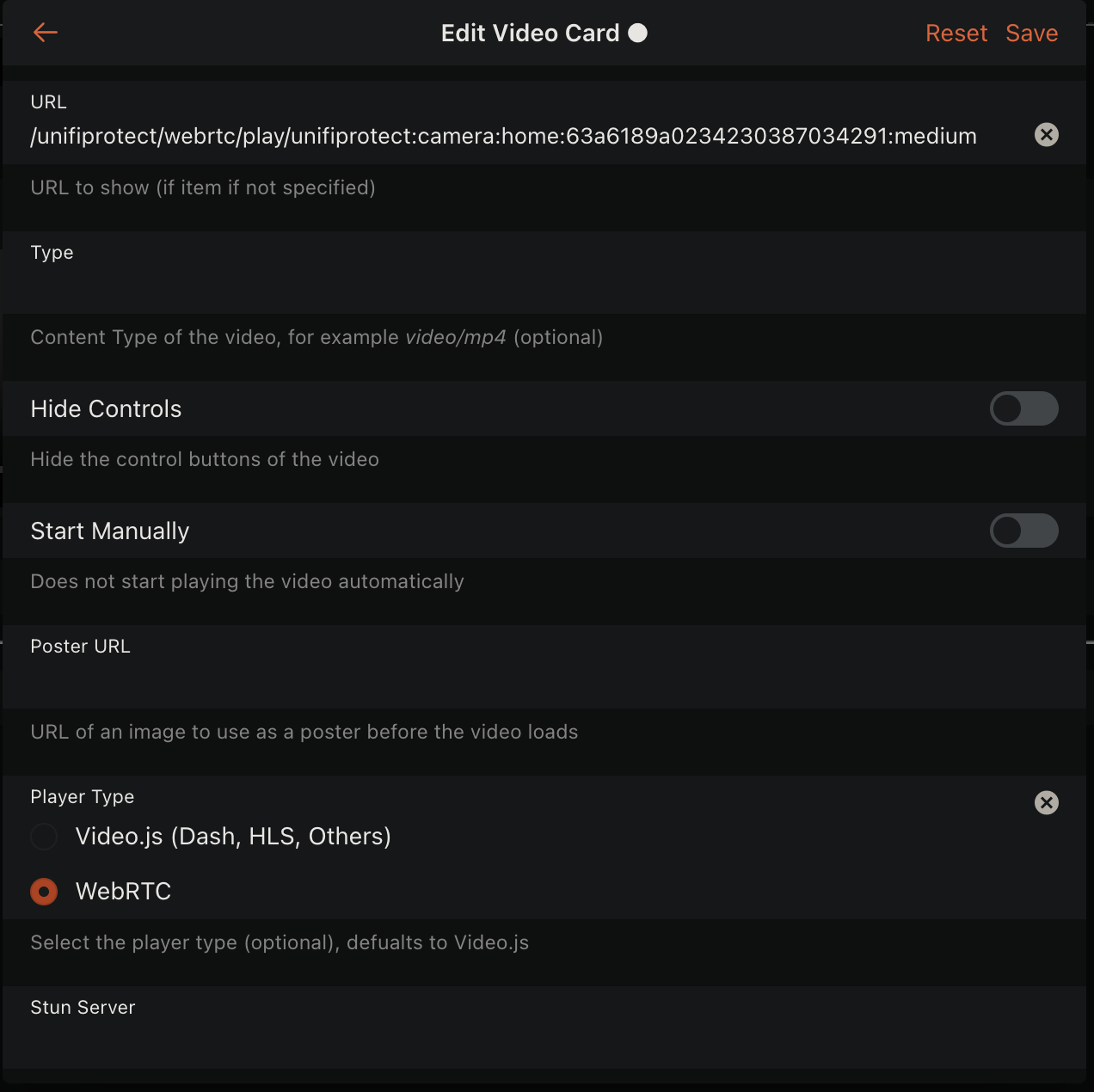

# camera Configuration
| Name | Type | Description | Required |
| deviceId | text | Unique device identifier of the camera | yes |
| enableWebRTC | boolean | Enable WebRTC streaming | yes |
When WebRTC is enabled, the camera will be able to stream through openHAB using WebRTC.
You can disable WebRTC by setting enableWebRTC to false.

# Stream URLs
The URL for WebRTC streams can be found in 2 different ways
- As a property on the Camera Thing (webrtc-url-high, webrtc-url-medium, webrtc-url-low, webrtc-url-package)
- As an Item linked to a channel on the Camera Thing (webrtc-url-high, webrtc-url-medium, webrtc-url-low, webrtc-url-package)
All of the above URLs are relative to the openHAB instance.
The playback URLs can be used in the MainUI video widget by enabling WebRTC in the advanced settings in the video widget and using an above URL or Item as the source.
An example WebRTC stream URL would be:
/unifiprotect/media/play/unifiprotect:camera:home:1234567890:high
Where unifiprotect:camera:home:1234567890 is the camera's Thing UID and high is the quality (high, medium, low, package) if supported by the camera.
You can either use the String URL or select the Item linked to the channel in the MainUI video widget.
